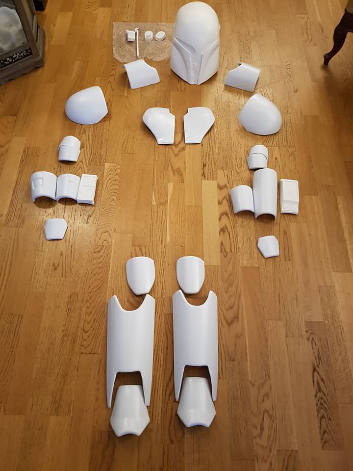

From the Rebel Legion forums I found out that Mandalorian Arsenal was a good place to get the armor kit, so I ordered from them http://themandalorianarsenal.com/armor.html#Sabine. They estimated 8 weeks production time, which they stuck to. I ordered my armor 13th of October 2017, and received it before Christmas (my package got stuck in Norwegian customs for over a week).

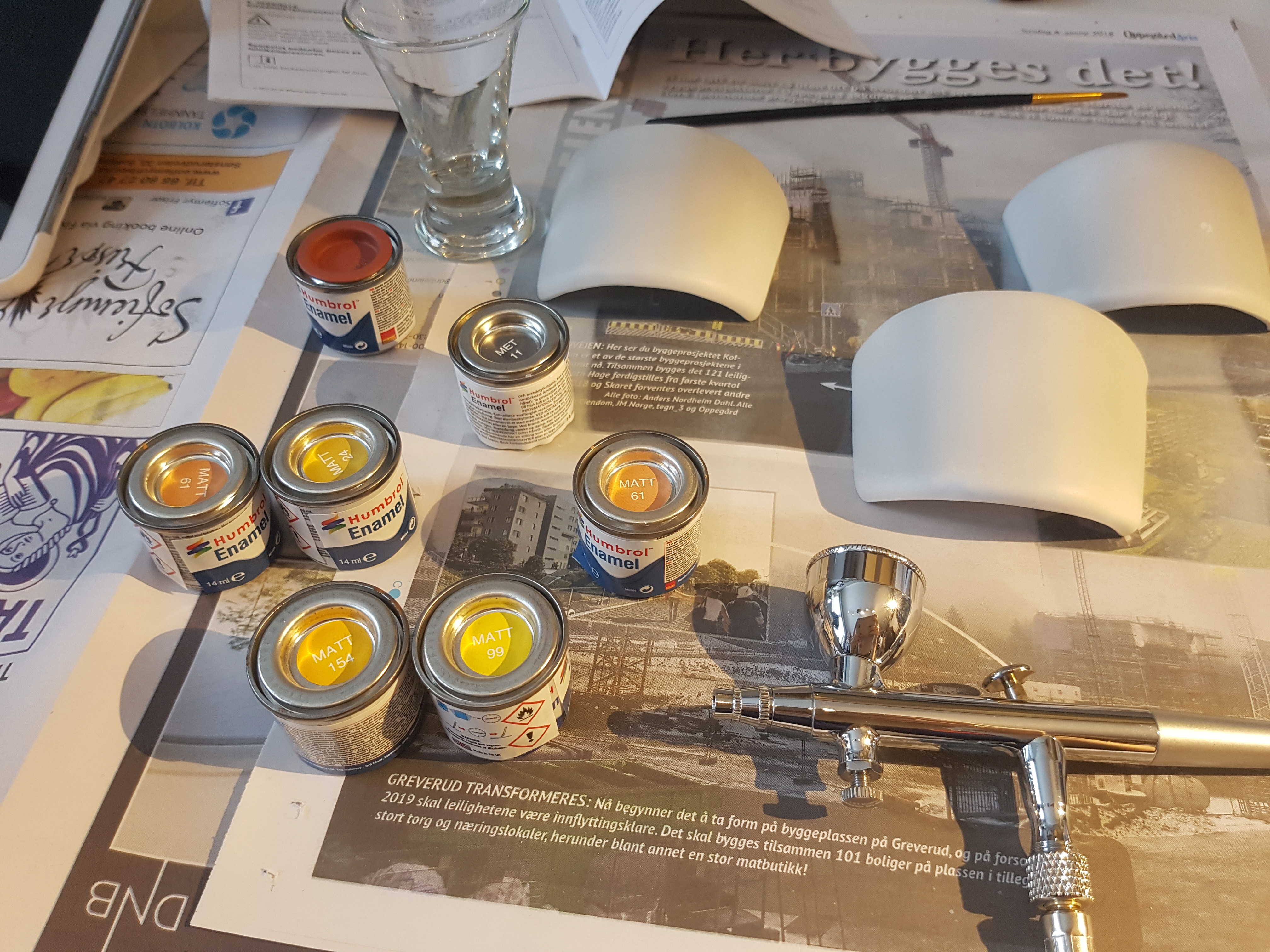

I am totally new to airbrushing. And the Sabine Armor is a whole lot of airbrushing. Therefore I thought I would start with something simple so that I may practice. And if I totally screw it up, I can just sand it down and start over again. So I chose to start on the elbows.
They are to be orangy-with a dark brown/reddish background and also metallic underneath.

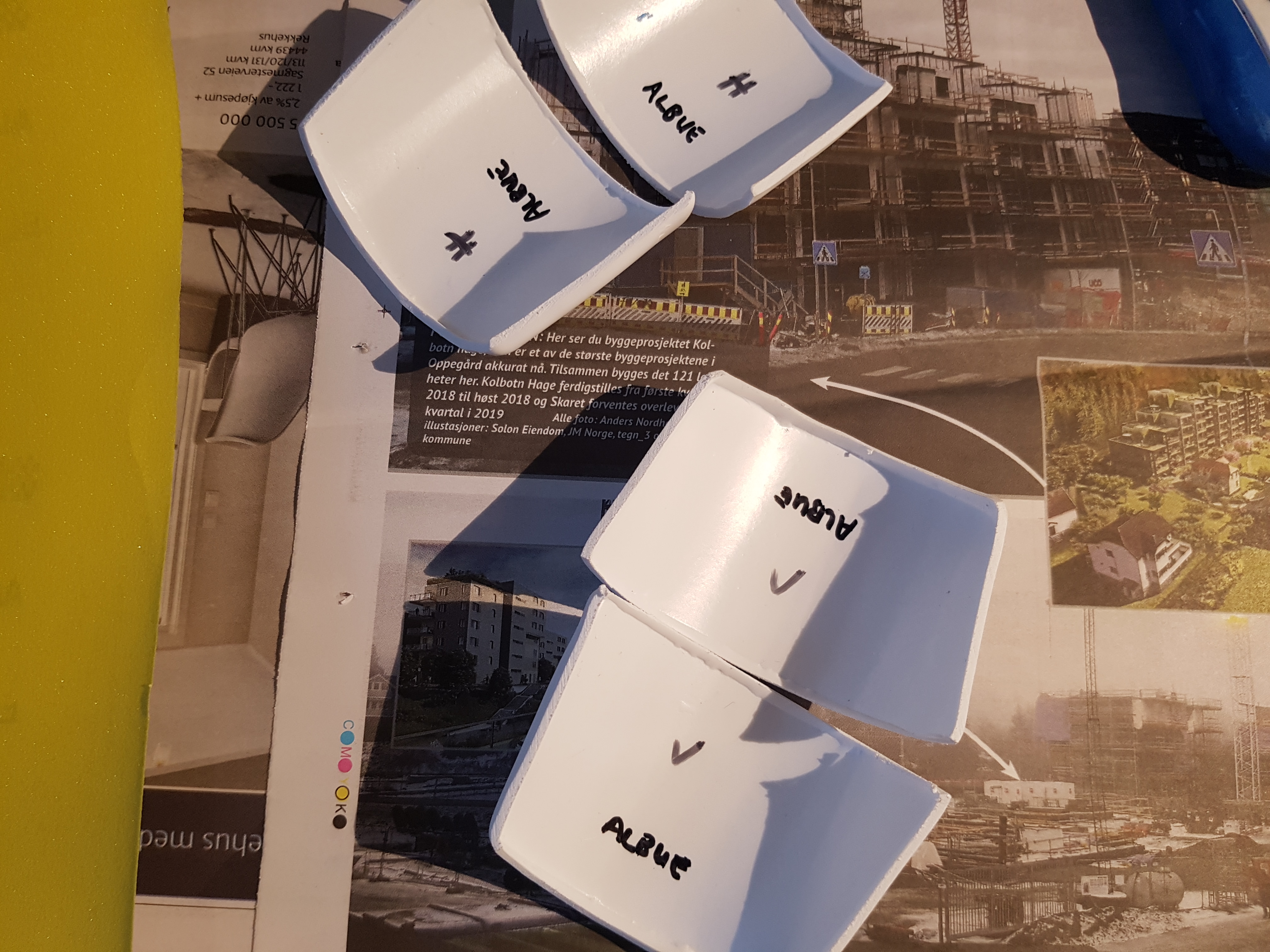

First off I marked my elbows. There are 4 pieces in total, two on the left and two on the right. I cut off the excess plastic and sanded them down all nice and smooth.
Then I primed them.

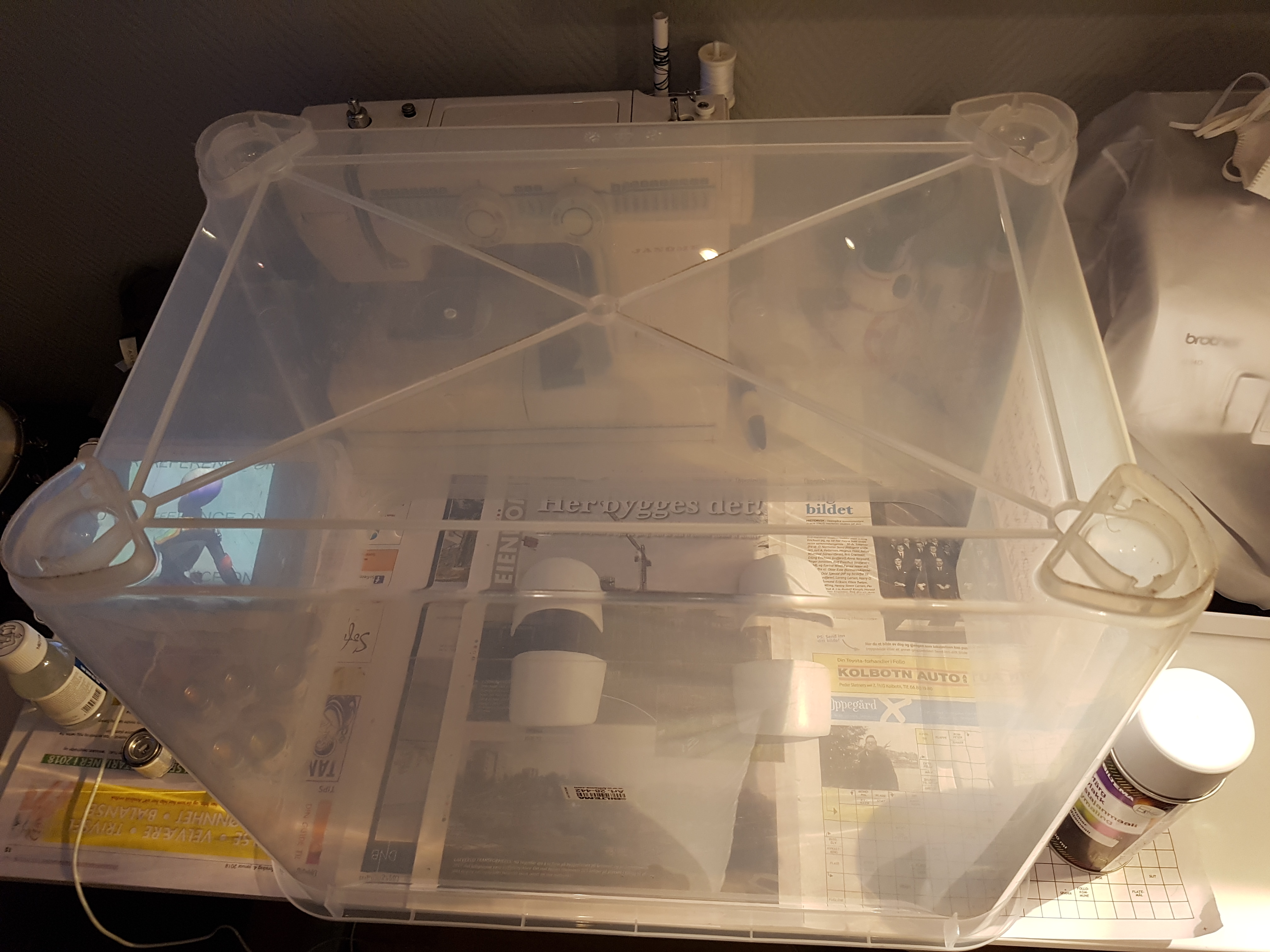

Since it is winter now, and I do not have any good places to spray, I found out that spraying inside this box worked pretty well:
And today was my first test with the airbrush:
It was a lot harder than I thought it was going to be. I thought I would have more precision and control, but I guess that comes after a while with practice :)

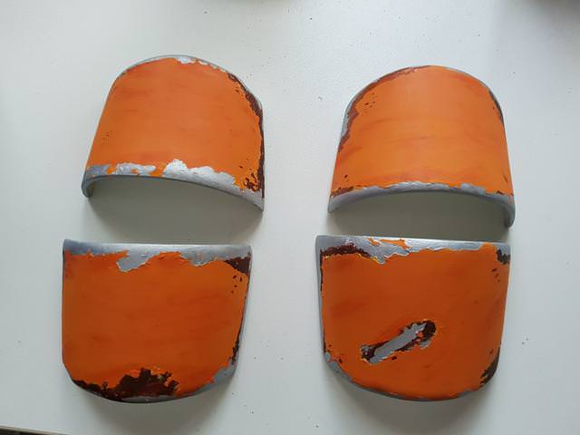

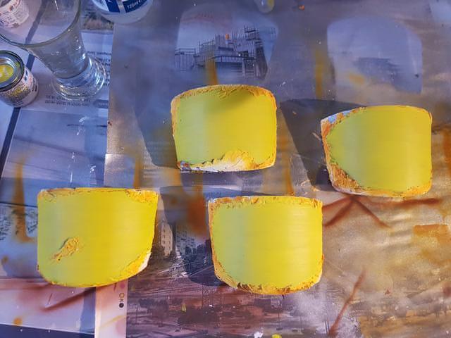

The Elbows are finished! I think they look pretty sweet. But if any of you have any comments, please say so :)

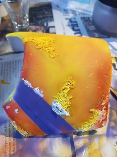

I used toothpaste as weathering. This has proven to work well in the past. So after I painted the silver/metallic I added toothpaste to the areas where I wanted the metal (and the brownish color) to come through. And thereafter I painted the elbows yellow so that the top color would seem brighter. I used a regular paint brush to evenly distribute the color. I wasn't too concerned about the brush strokes as there will be a top coat of a different color.
On top of the yellow I painted the orangy color. I used some time to get the color right, and found out that I needed red, yellow and a little bit of pink :)
After all the paint was dry, I scraped off the places where the toothpaste was. The metallic had, in some areas, become white-ish. So I topped up the metallic with a brush afterwards. I think the end result looks good :)

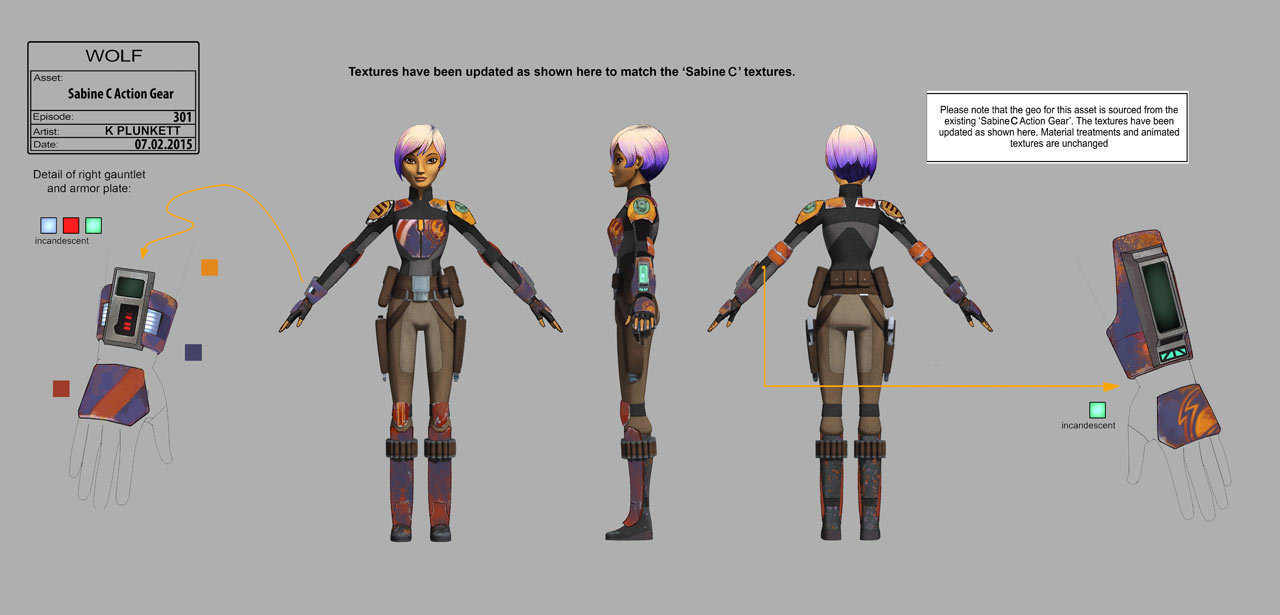

Reference image:
