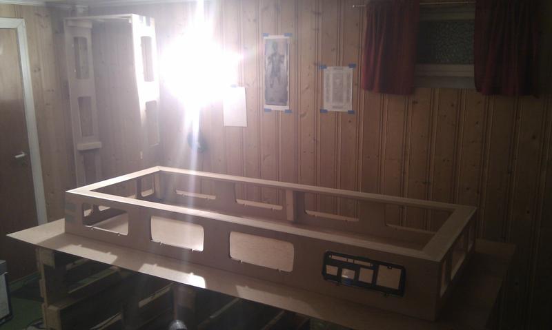

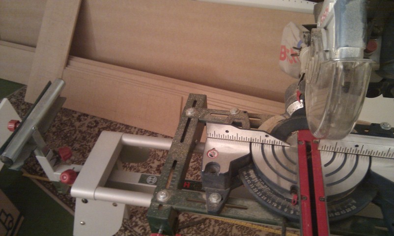

Then I thought: "Why not just cut the parts myself?" So I did. Or I got my landlord (who works as a carpenter) to help me buy the wood and get all the proper lengths cut, then I cut all the angles and holes for the panels myself. The best part, it ended up costing me under $100, for two boxes.
This has been a real friend:

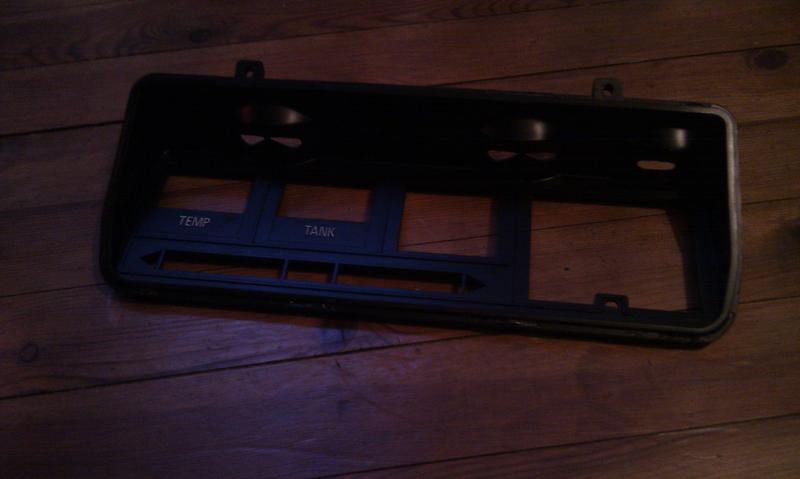

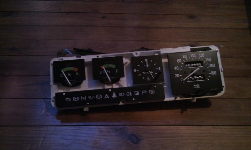

Meanwhile, I also tried to source an original Volvo instrumentpanel, something that didn't prove to be so difficult, as the Volvo 343 was a pretty common car here back in the day, so some scrapyards have parts laying around.
After contacting 4-5 scrapyards I got a hit from two of them, and one even had several instrumentpanels.
Trouble is, they are still so expensive, that buying more than one was out of the question.
I came across Matt Munsons blog detailing how to make a mold and slushcast the instrumentpanel, so I think I will be giving that a go, as it would be both fun to try and a fairly cheap alternative (I believe). I have never tried it before, so it will be a great learning experience.

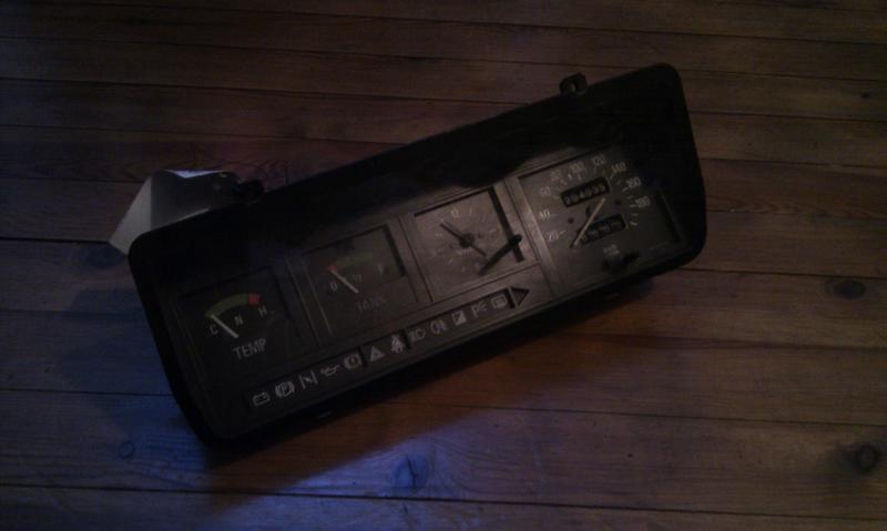

Here is how the Instrumentpanel arrived:

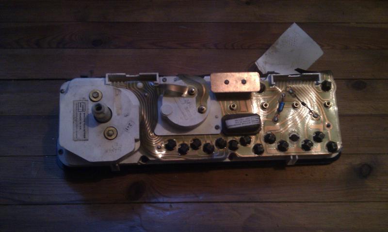

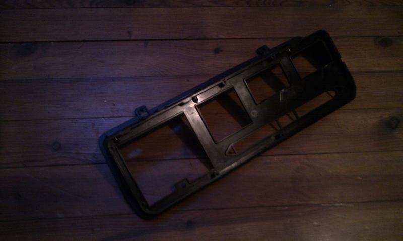

With instrumentcluster removed:
I am using MonCal's excellent HIC build as reference and inspiration, as well as looking at a few other builds for tips on how to solve stuff.
Measuring the placement of the side panels:

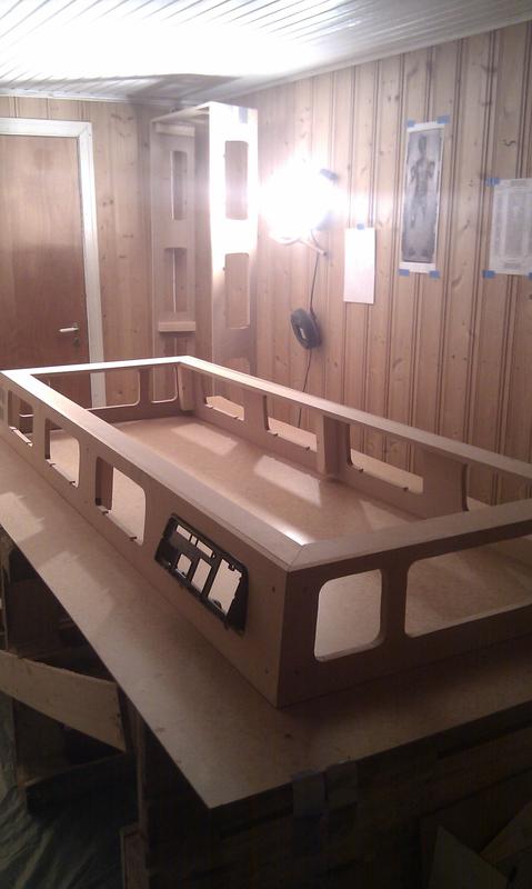

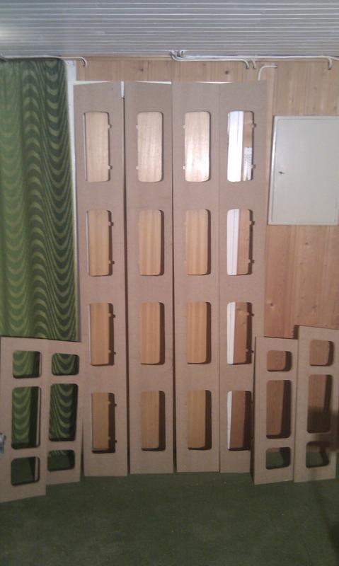

All four sides of both boxes ready:

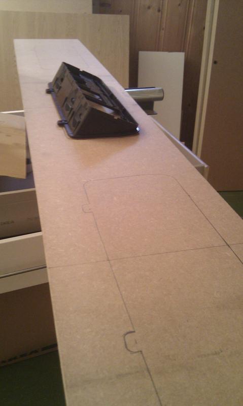

And here is where I'm at now:
The next step will be routing all edges, mounting the backing behind the holes for the sidepanels, bondoing and sanding all screwholes and edges. Then mounting crossbraces inside the box to stiffen it off and provide a backing for the board on which Han will be mounted.

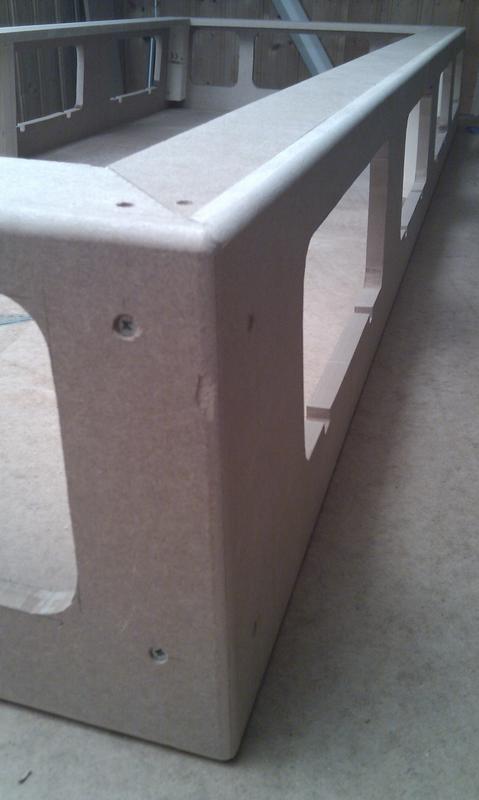

Had another round with the saw and got to bust out the router today.
Now both frames are at the exact same stage, and all edges are routered smooth.
Some bondoing and sanding is needed, but the boxes actually look a lot better than the impression this picture gives! :P
Next up is mounting the backing behind the holes for the sidepanels, and strengthening the overall integrity of the box.
Then bondoing and sanding, before making the main panel for Han and attaching that.
Small increments!
This build includes a lot of slightly askew angles and routered edges, and you really have to keep your tongue straight when measuring out before cutting, so I can understand the people that have mentioned that this is a time consuming and difficult build. But if you just keep your head cool and think things through it shouldn't be a problem.
